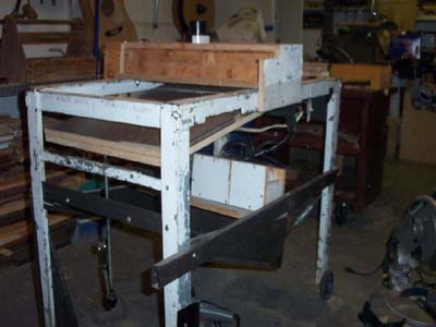

My DRUM SANDER! I'd say homebrew by i only drink soda!
That is my favorite because it was the first time i built a power tool from scratch and for how it helps in the shop!
The table lifts or lowers from a 1/2" threaded rod passing through 2 welded bolts on the frame, 1/4 turn at a time and it sands a hair thick!! the motor is 1/2 hp and the drum is made with black ABS pipe with 3" dia ply discs through which passes the shaft. The shaft is inserted in 2 pillow block bearings and at one end of the shaft, there is a pulley and the belt linked to the motor!

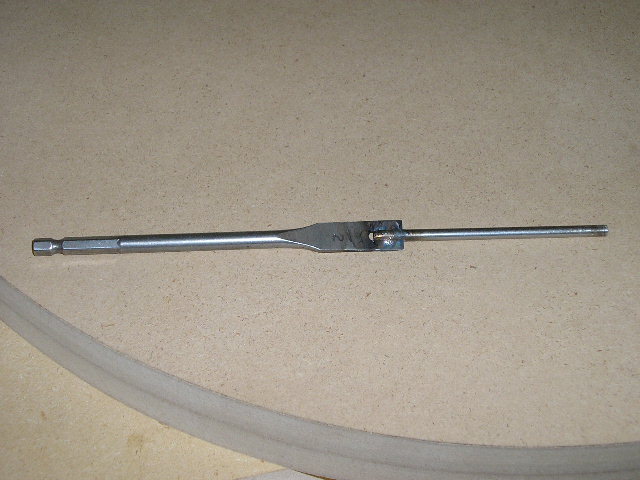

This is for drilling the counterbore for the truss rod nut in the head stock. It works great.

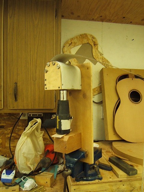

The other jig that I like (needs a little work though) is my cut away bending form. It uses a heat gun for the heat source and bends the part perfectly (well, I just need to remake the shape, than it will be perfect).

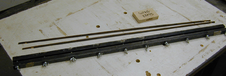

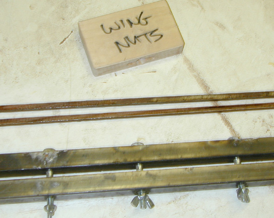

Here's another - doesnt get used all that often, because I usually make binding by laminating the binding and purf together in 1 inch wide pieces, then slicing up all in one on the table saw. But, every once and a while, you need to separately glue purf lines to a single piece of binding. My friend Scott Sheppard has a jig like this, he made his from aluminum tube, I figured steel would be just as good. So, the bolts give you something to set the bind and purf against inside the jig, to keep them lined up - the wing nuts tighten her all up,and away you go, one at a time. The bolt heads are welded so they wont turn. Heres a couple pieces of cocobolo, with braz/maple as the purf added on. I glued them wide, at about .140, so I can easily trim them on the table saw to final size - about .085 or so. I also made a small handle for tighening and loosening the wing nuts. You can them pry the tubes apart with a stright screwdriver balde easily.
